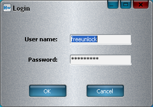

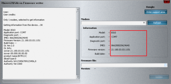

Launch software

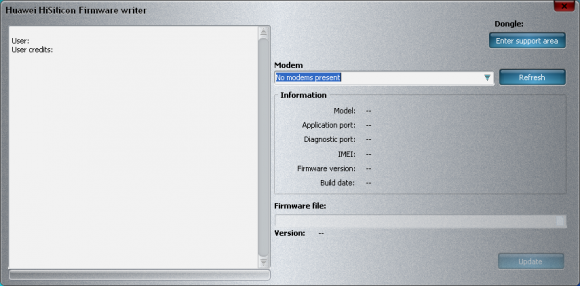

Afterwards, Huawei HiSilicon Firmware writer software window will appear

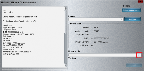

Connect Huawei B310 to PC via USB then check adapter binding settings like shown here or disable router's adapter. Then wait minute or 2 until it is recognized on computer then click "Refresh" button, wait for device to be detected on software
Click paper icon above Update button

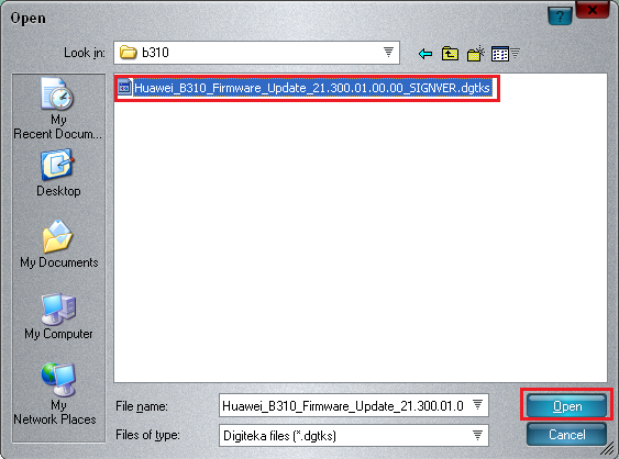

Select firmware (21.300.01.00.00) file for decustomization. File can be downloaded from DC-unlocker support area which is accessed directly from flasher by pressing button "Enter support area"

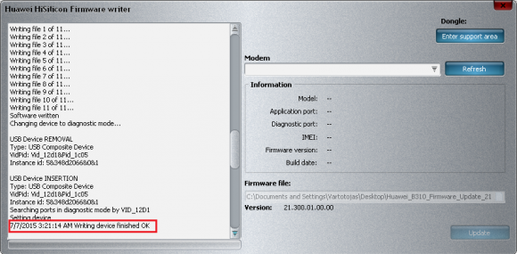

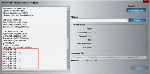

Click Update button and monitor the process
At the end a message will appear that flashing has been completed successfully
Now device has Huawei user interface without custom brand logo
