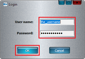

If there is no DC-Unlocker/Rocker/Vygis or Infinity dongle connected to PC, then log in screen will appear. Use your timed license account details to log in

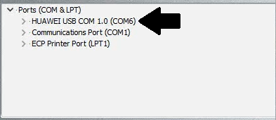

Make sure phone is visible in device manager under ports correctly. This can be checked now directly on DC-phoenix. Device should be connected via Testpint

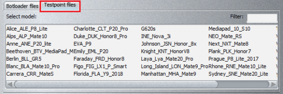

Option 2. You may put phone in testpoint mode by short circuiting hardware testpoint, available known locations of testpoints on mobiles can be found in "Testpoint files" tab

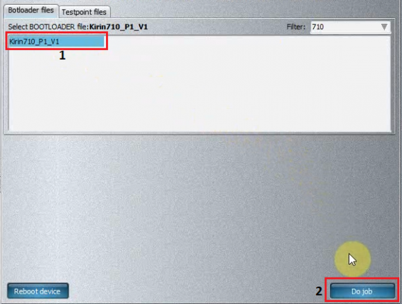

Open "Update by TP" tab, choose "Unlock Huawei ID by testpoint" option

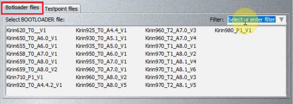

In "Bootloader files" section select correct loader for your phone, matching it's CPU
Make bootloader selection and press "Do job" to begin
NOTE: this is just example, make selection according to your phone's chip!!!

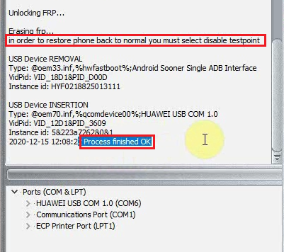

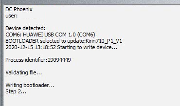

Monitor the process
Step 7
Wait for message indicating process success. Depending on phone it may remain in testpoint mode which you need to disable in order to restore phone back to normal
