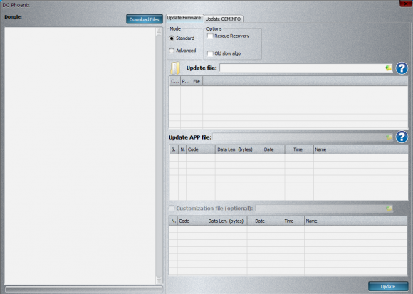

Launch the program
Connect phone to PC via testpoint. It must be visible under Ports section in device manager as HUAWEI USB COM 1.0
On DC-Phoenix click file select icon and choose special downgrade board software which will have "Downgrade" word in it's file name.
To download this board software visit DC-phoenix support area which is only accessed directly from software by pressing "Download file" button.
Then can press "Update"
Monitor flashing process, phone will enter fastboot soon after flashing begins, it must appear as example below, otherwise flashing device will fail:
