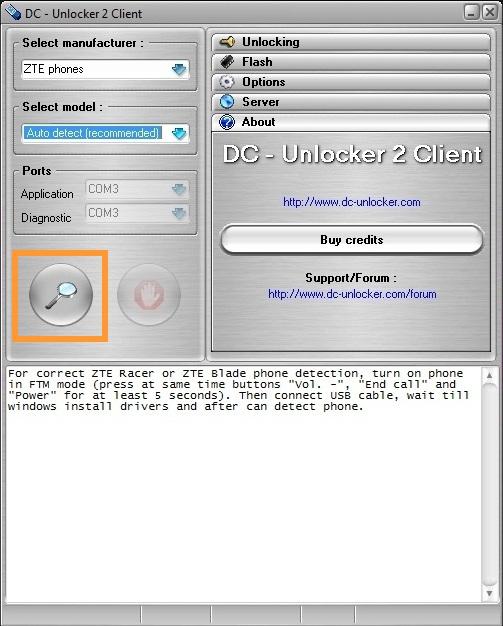

Select ZTE phones, select model Autodetect (Recommended).
ZTE Racer, Blade detect and unlock procedure. Select manufacturer and model
ZTE Racer, Blade detect and unlock procedure. Press detect button

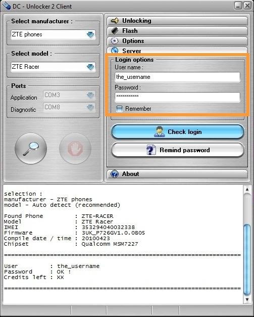

Enter your username and password. If DC-Unlocker/Vygis/Rocker/Infinity dongle is connected, do not enter username and password, only click "Check login".
ZTE Racer, Blade detect and unlock procedure. Enter your username and password.

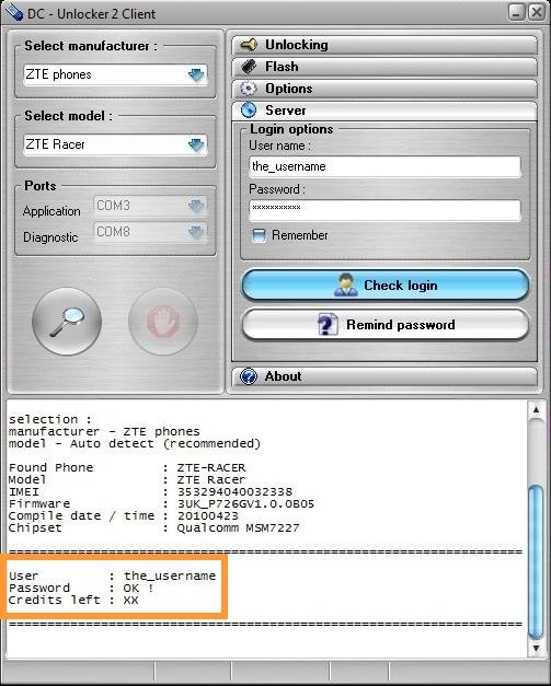

Press Check login button. You will see your username and how many credits left.
ZTE Racer, Blade detect and unlock procedure. Press check login

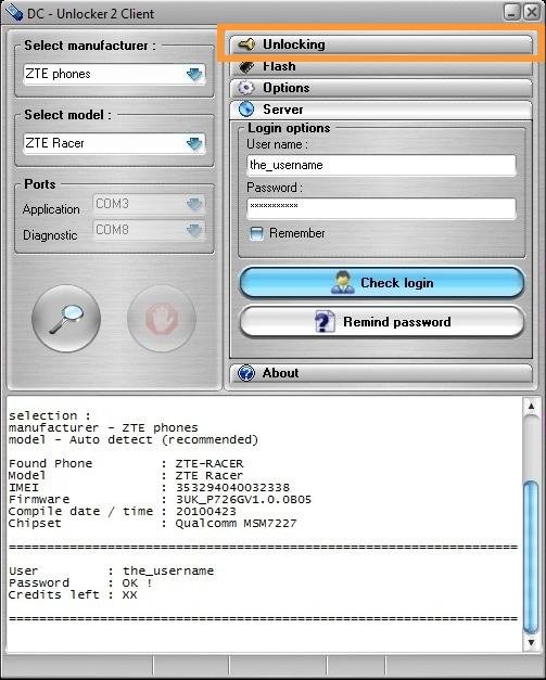

Go to Unlocking tab.
ZTE Racer, Blade detect and unlock procedure. Unlocking tab
