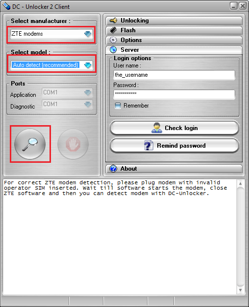

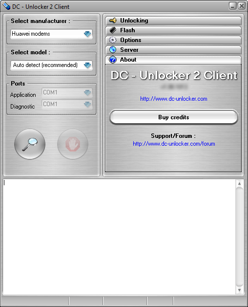

Press "Detect" button (Big magnifying glass):
Wait till DC-Unlocker fully detects modem:

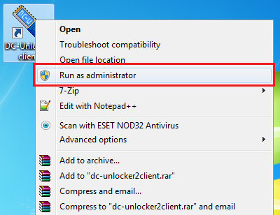

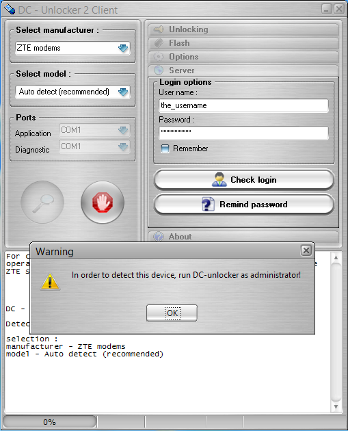

If you get warning window during detection,run DC-unlocker as administrator.

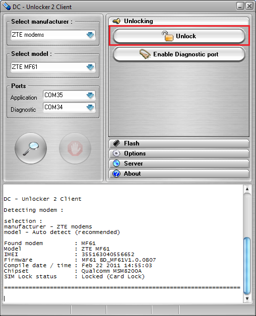

Open Unlocking tab, click “Unlock”.

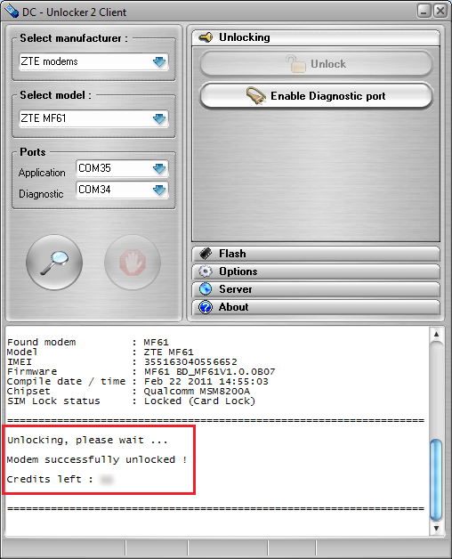

Wait till you see a message that modem is unlocked.
