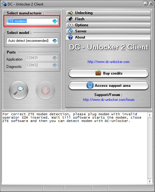

Select ZTE Modems from manufacturers drop down menu

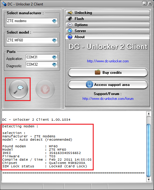

Click Detect button (big magnifying glass icon) and wait for device to be detected

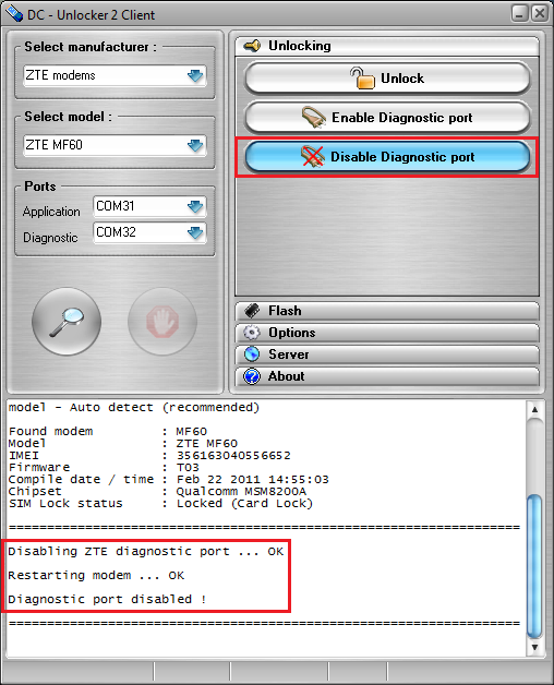

Proceed to Unlocking tab. Click Disable Diagnostics port button and wait for software to finish the procedure
Now reconnect/restart device.
