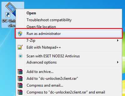

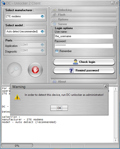

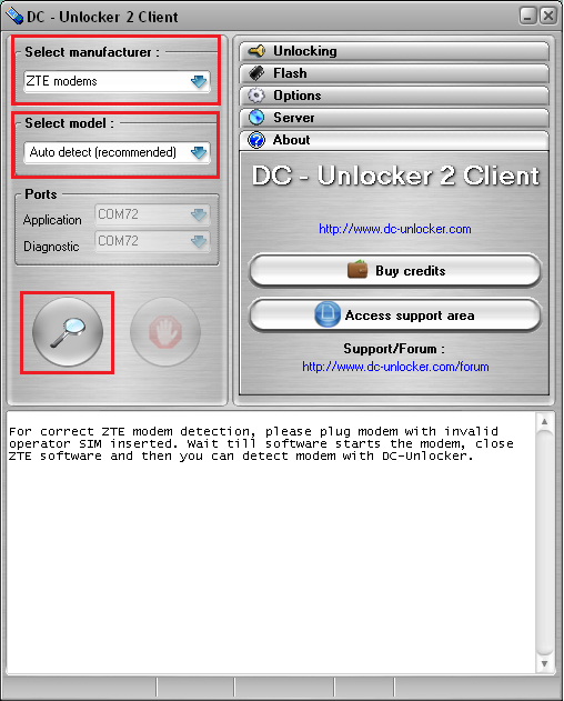

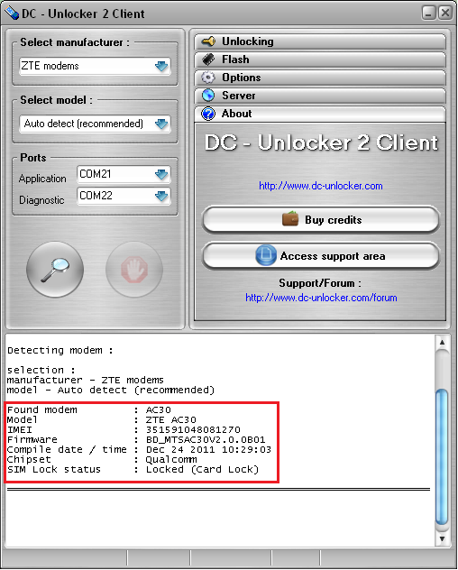

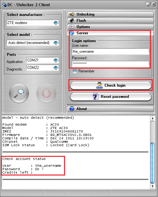

If you get "modem not found" error message, run DC-Unlocker as Administrator and perform detection again. Make sure drivers of the device are installed as well
Go to server tab, enter username and password, click "Check login". (If you do not have username for DC-Unlocker software, you can buy credits to receive it: www.dc-unlocker.com/buy)

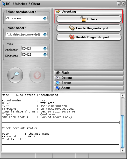

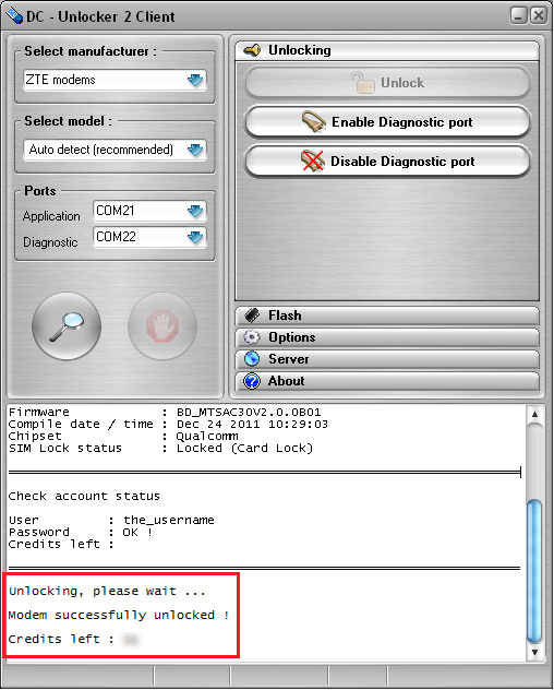

Open unlock tab and press Unlock button
After you see that modem is successfully unlocked, remove battery and restart modem.
