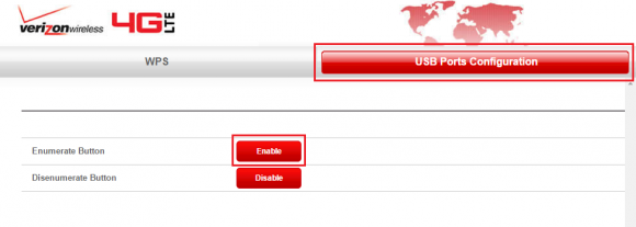

After accessing web gui, go to "USB Ports Configuration" and click "Enable" button
NOTE: if your device's web ui looks differently or has more options on it and you can not find the right place, go directly to this address - 192.168.1.1/company_use.asp
192.168.1.1 might be different, depends on configurations that device is set

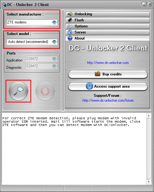

Launch DC-unlocker software

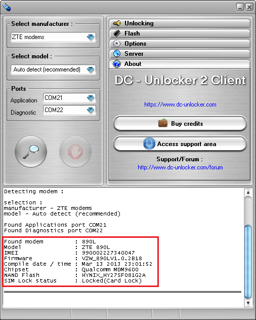

Select manufacturer: ZTE modems, model leave Auto detect (recommended). Press "Detect" button (Big magnifying glass)
Wait till DC-Unlocker fully detects device (this specific model might take longer to be detected than usual)
If you get "modem not found" error message, run DC-Unlocker as Administrator and perform detection again. Make sure drivers of the device are installed as well

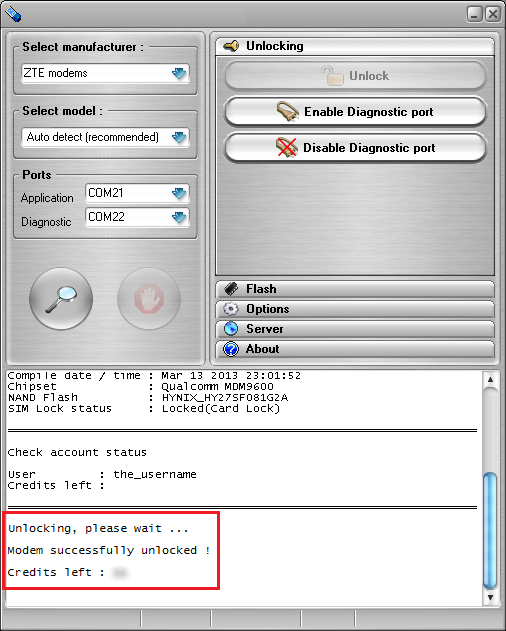

After you see that modem successfully unlocked, restart it. Now you can use it with any SIM card
