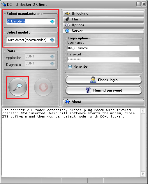

Go to server tab, enter username and password, click "Check login". (If you do not have username for DC-Unlocker software, you can buy credits to receive it: www.dc-unlocker.com/buy)

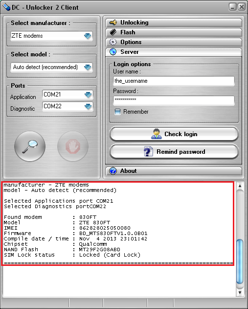

Select manufacturer: ZTE modems, model leave Auto detect (recommended). Press detect button (Big magnifying glass)

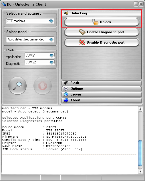

Open unlock tab and press unlock

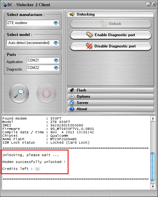

After you see that device is successfully unlocked, restart it
