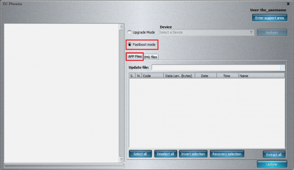

Launch the program
Select "Fastboot mode", open "APP Files" tab
Make sure you have HiSuite installed (but closed) on your pc, it will be necessary for latest device drivers
Connect phone in fastboot mode. Power down mobile device. Hold Vol- and connect phone to usb cable, this will enter fastboot mode.
Note: remove SD card from mobile if there is one inside.

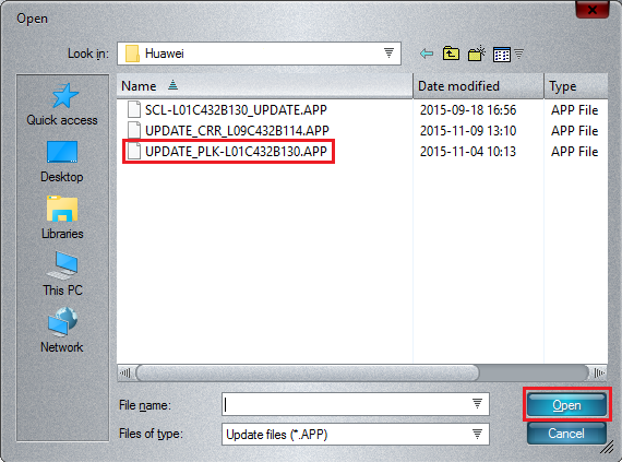

Press paper icon next to "Update file" field
Select update.app file for flashing. Click "Open"

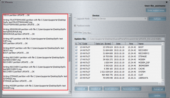

Click "Update" button and monitor the process
Step 8

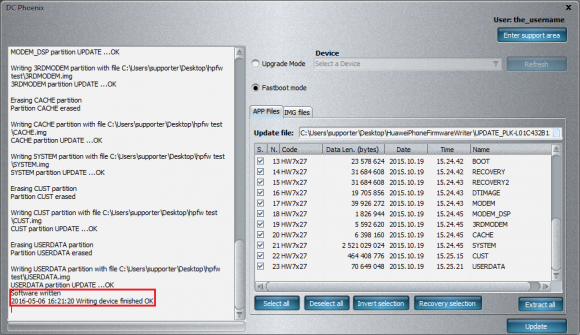

Wait for flashing to finish, when it's complete you will see message on program's memo window
Disconnect phone from PC and restart to end the process
