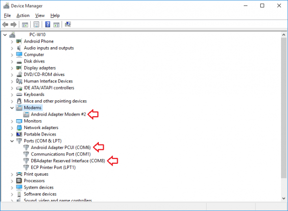

IMPORTANT: Enable "manufacture mode" on your phone. This is done by entering in dial pad code *#*#2846579#*#*, select "Project Menu", "Background settings", "USB ports settings", "Manufacture mode". Then connect it to PC and install drivers
Install drivers for your phone by downloading and installing HiSuite software or by downloading this driver pack and applying drivers manually. After driver installation your phone in device manager must look like in the image below

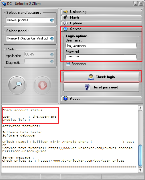

Launch DC-unlocker software
Detect device by selecting Huawei phones from manufacturers drop down menu list, "Select model" leave on Auto detect (recommended), then read the info on software for how to correctly prepare phone for detection. After phone is prepared, connected to PC and it's drivers installed, click magnifying glass button
Click here is you don't know how to get user account
Open Unlocking tab, click “Read unlock codes” button
