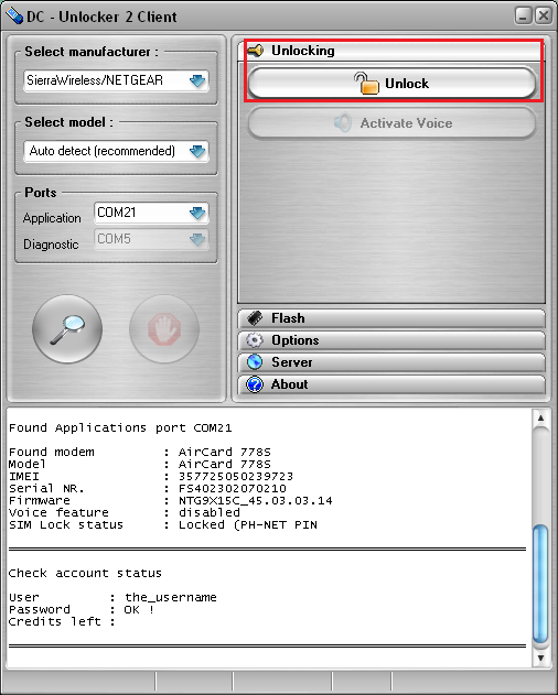

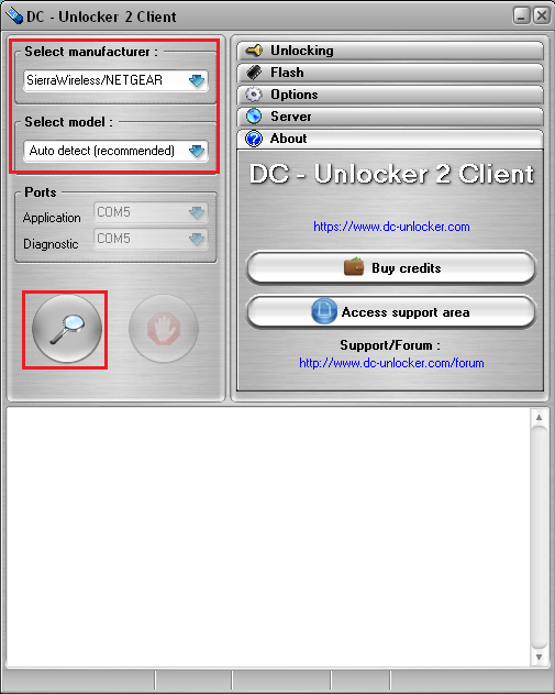

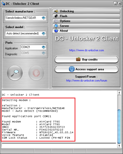

Device should be connected to PC via usb cable and installed properly with drivers that it has in it's virtual drive which appears in computer after connection. Make sure there is no sim inside device before proceeding to detect/unlock steps

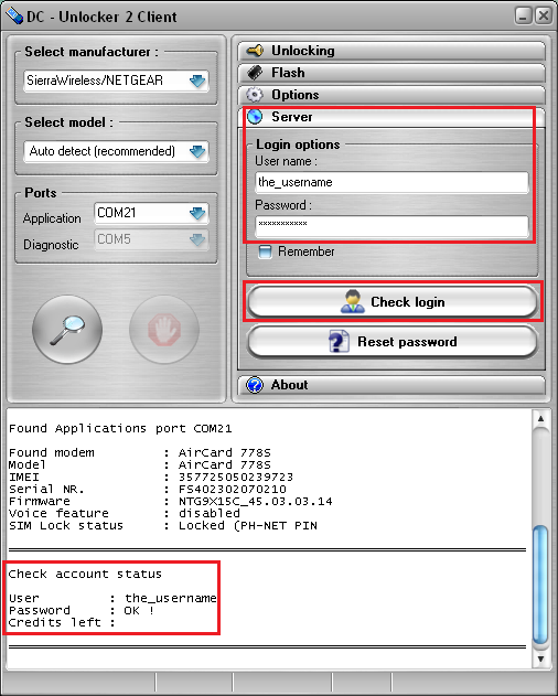

Note: if you can't login or get error connecting to server after connecting Netgear AC778s to PC, check these settings here

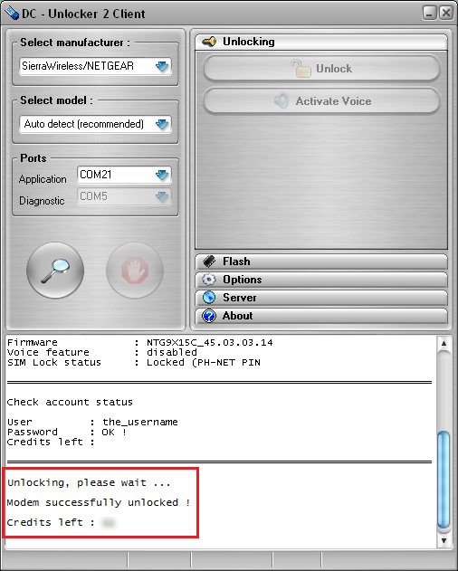

After you see that modem was successfully unlocked, restart it by disconnecting and connecting back. Set correct APN for different operator's card (if ou do not have APN or don't know it, it isreceived by calling operator of sim card that oyu try to use device with). Now you can use it with any SIM card
