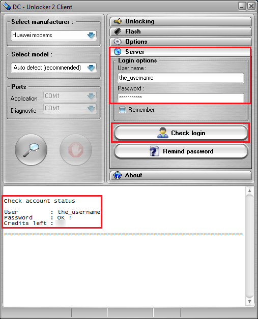

Open Server tab, enter your username and password that you received after credits purchase. Click "Check login". (you can buy credits here www.dc-unlocker.com/buy).
If DC-Unlocker/Vygis/Rocker/Infinity dongle is connected, only click " Check login ".

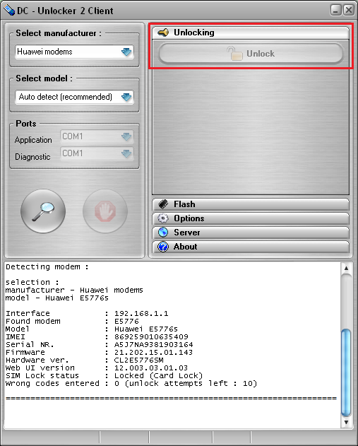

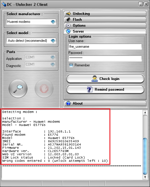

Detect device by selecting Huawei modems from manufacturers drop down menu list, leave Select model as auto detect (recommended) then click magnifying glass button.

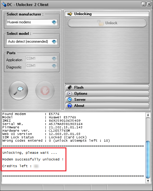

Open Unlocking tab, click “Unlock”. If there are more options below "Unlock / "Do job" button then leave it as it is selected by default
After you see that device was successfully unlocked, restart it. Now you can use it with any SIM card.
