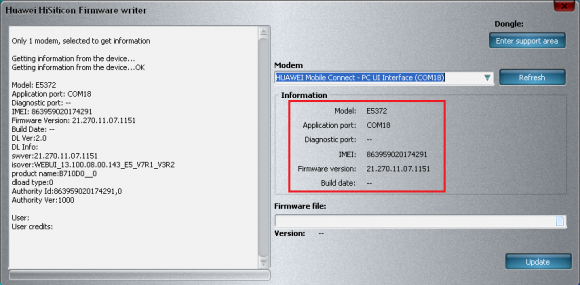

Connect Huawei E5372 to PC. Then wait minute or 2 until it is recognized on computer then click "Refresh" button, wait for device to be detected on software

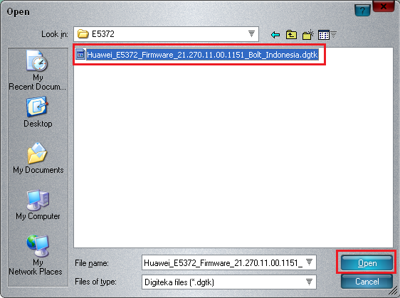

Click paper icon above Update button
Select firmware file for decustomization. File can be downloaded from DC-unlocker support area which is accessed directly from flasher by pressing button "Enter support area"

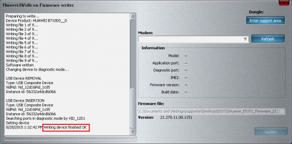

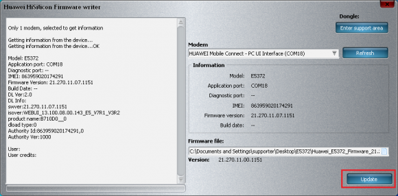

Click Update button and monitor the process
At the end a message will appear that flashing has been completed successfully
Now device has not customized firmware in it and ready for unlock
