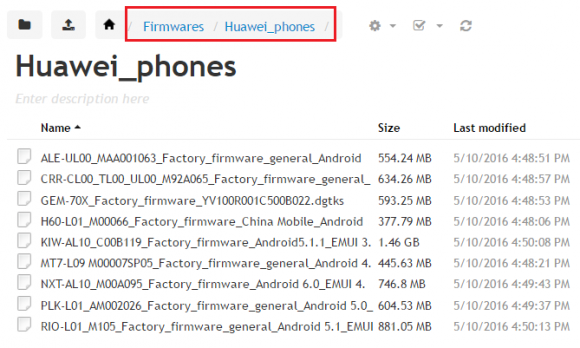

Download factory image file from DC-unlocker support area. Enter support area from DC Phoenix by pressing "Enter support area" button
Navigate to Firmwares / Huawei_phones folder. Choose factory firmware file that is most similar to your device model, if no such model available try to contact support for the file
Step 7
Select .dgtks file of your phone for flashing. Click "Open"
