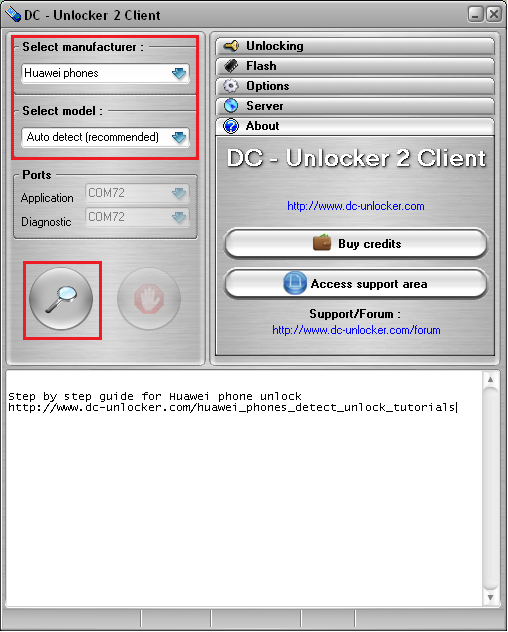

Launch DC-unlocker software

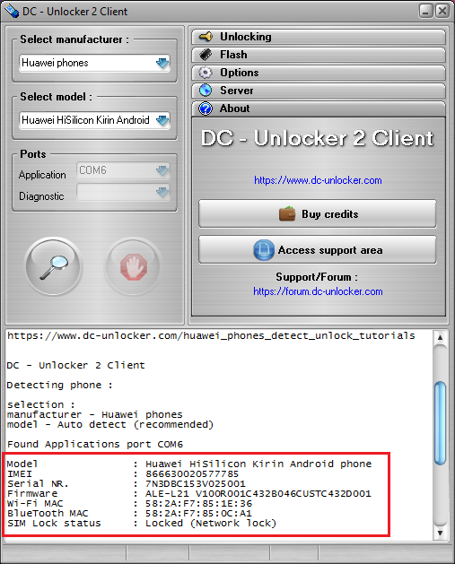

Detect device by selecting Huawei phones from manufacturers drop down menu list, "Select model" leave on Auto detect (recommended), then read the info on software for how to correctly prepare phone for detection. After phone is prepared, connected to PC and it's drivers installed, click magnifying glass button

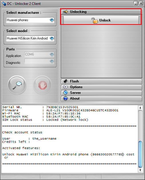

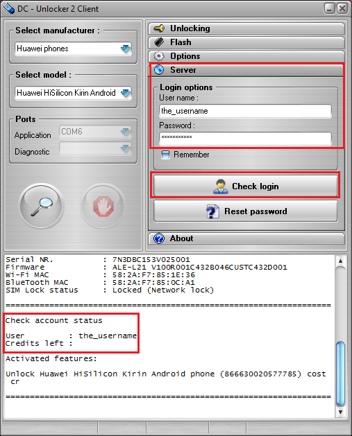

Click here is you don't know how to get user account

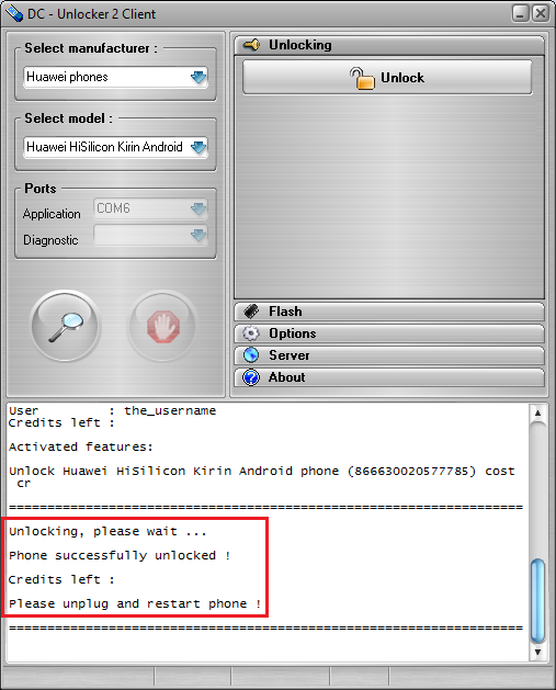

After you see that phone was successfully unlocked, restart it to complete procedure. Now you can use it with any SIM card. You can restore phone now to it's previous mode
