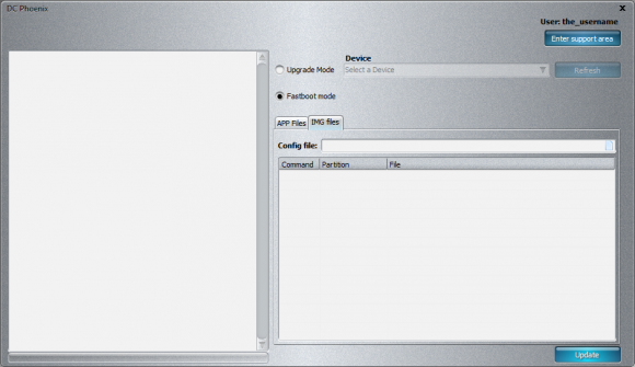

Launch the program
Step 7
Select "Fastboot mode", open "IMG files" tab and click on paper icon next to Update file field
Step 8
Select "Config.txt" file that you jst created. Click "Open"
Step 9
Review files prepared for flashing on software window, if everything according to your needs can click "update" button to start flash process (Note: phone should be connected to pc in fastboot mode before pressing Update).
