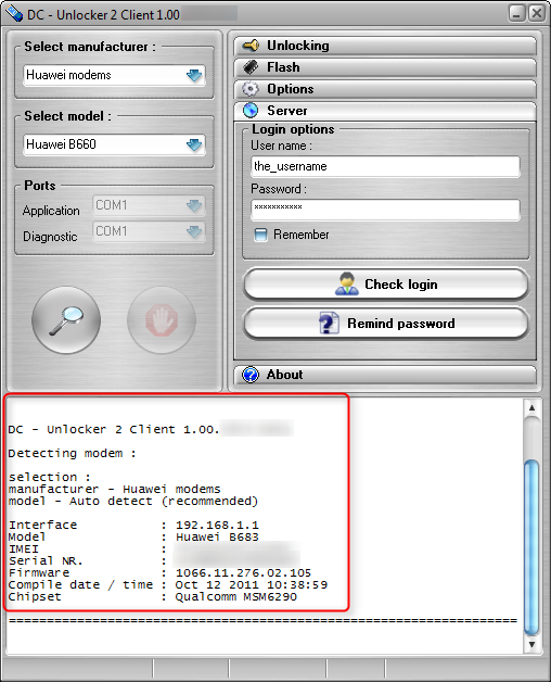

Select manufacturer: Huawei modems, model leave Auto detect (recommended).
Press "Detect" button (Big magnifying glass).
Select Novatel and auto detect
Wait till DC-Unlocker fully detects modem.

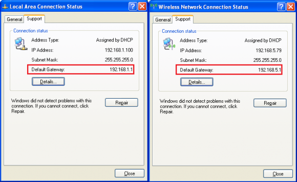

If you get "modem not found" error, check this procedure You might need to turn off firewall and User Account Control (UAC). Step-by-step procedureMake sure router has its Gateway IP set correctly as well (it can not be same as wifi's if it is enabled on computer during detect time)

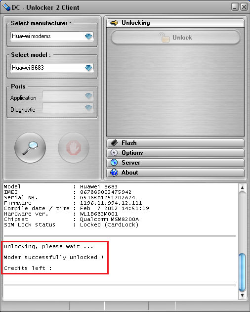

Open Unlocking tab, click Unlock
After message appears that device was unlocked, restart it to complete the procedure. Now you can use it with other operator sim cards
