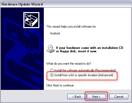

Huawei C8500/C8511 detect and unlock procedure step 3
Select "Install from a specific location". Click "Next".

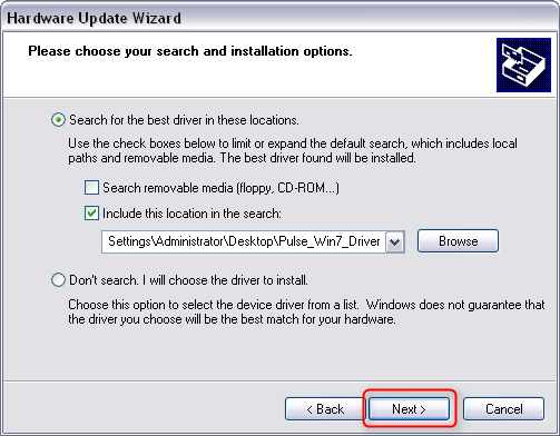

Huawei C8500/C8511 detect and unlock procedure step 4
Select "Search for the best driver in these locations". Click "Browse".

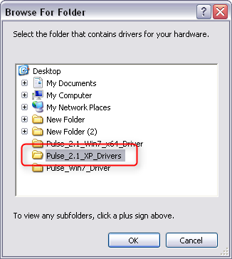

Huawei C8500/C8511 detect and unlock procedure step 5
Find and select folder with drivers that you downloaded and click "Ok".
Huawei C8500/C8511 detect and unlock procedure step 6
Click "Next".

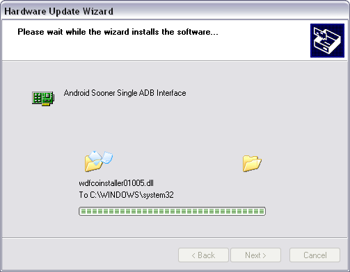

Huawei C8500/C8511 detect and unlock procedure step 7
Wait till windows install drivers.

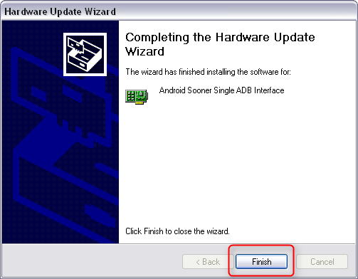

Huawei C8500/C8511 detect and unlock procedure step 8
Click "Finish".
Huawei C8500/C8511 detect and unlock procedure step 9
Now your phone should be named as "Android Sooner Single ADB Interface" in Device Manager.
