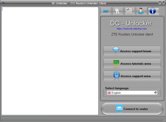

Launch software - right click on program icon and select "run as administrator"

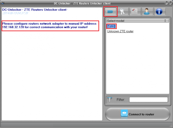

Open Models tab and select MF29. Read provided information on the program

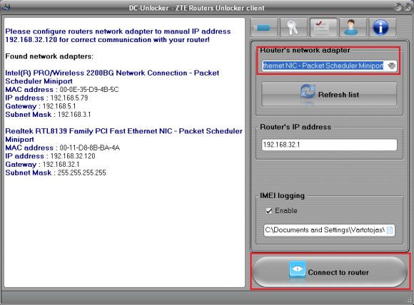

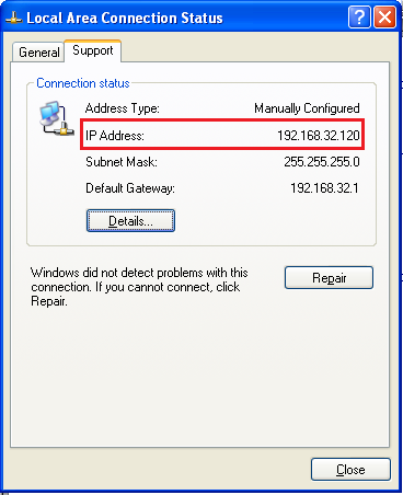

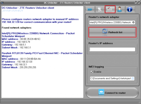

Set adapter's IP to which router is connected to, like requested by software. During manual IP entry leave Subnet Mask and Default Gateway fields empty

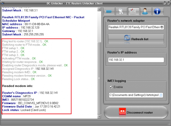

Open "Advanced settings" tab and click "Refresh list" button
Select router's network adapter from the list and click "Connect to router"
If router's network adapter was not detected then wait longer and click "Refresh list" again
Wait for device to be fully detected

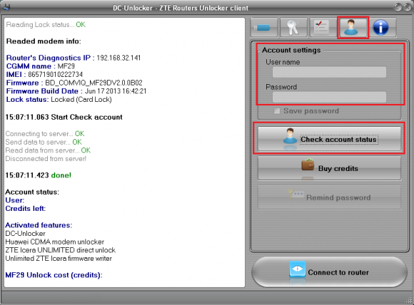

NOTE: if device was not detected then you must restart it before trying to detect it again! Remember to wait at least 1 minute arfter you turn on and connect router to PC! Set device back to it's default settings - do not change IP manually

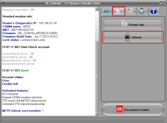

If DC-Unlocker/Vygis/Rocker/Infinity dongle is connected, only click "Check account status"

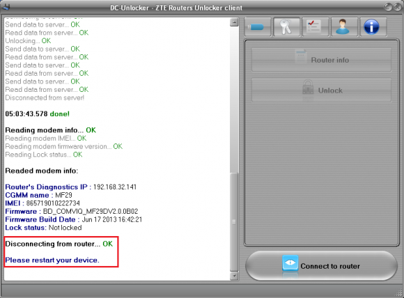

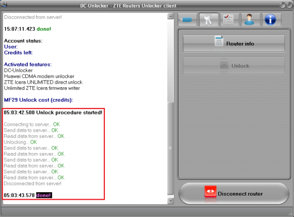

Proceed to "Unlocking" tab and click "Unlock" button
Wait for router to be unlocked

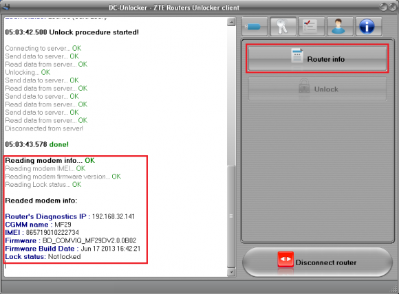

After message appears that unlock was finished, click "Router info", device will be detected now as unlocked
To complete unlocking click "Disconnect router" and restart device like suggested on the program
