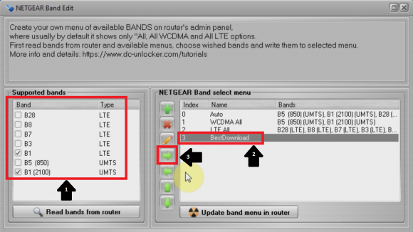

A new window will appear, press "Read bands from router". On the left will be shown available bands, on the right currently existing menus

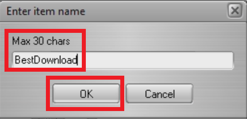

Enter custom menu name and press "OK"

To add custom bands to manu first select bands on the left, then mark menu on the right and press "->" arrow button
