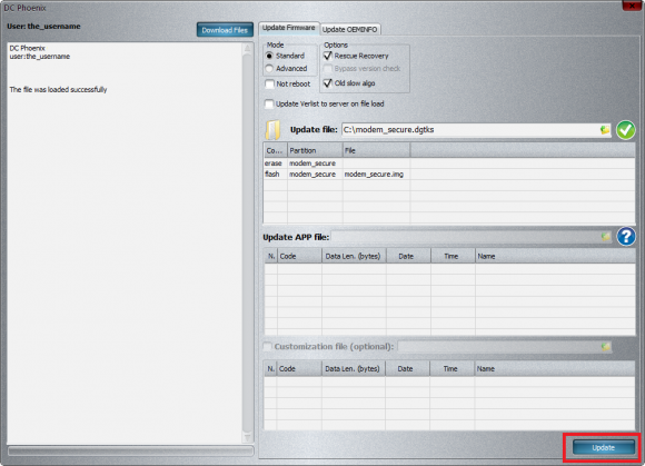

Launch DC-Phoenix program
Connect phone to PC via testpoint. Use HCU to put it in fastboot by loading loader. It must be visible in device manager after it as shown in example below.
On DC-Phoenix click file select icon
Step 5
In selection window choose file downloaded from this guide
Step 6
After selecting the file make sure Mode is set to default "Standard", then can press "Update"
Wait till software indicates flashing process completion.
Now you can disconnect the device from the PC and repeat IMEI/MEID repair process on HCU.
