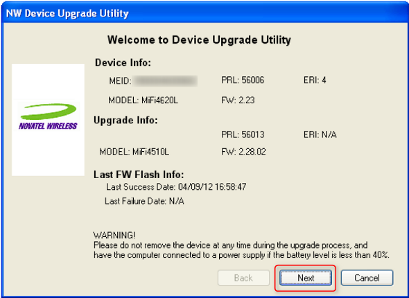

You will see Device info and Upgrade info. Click "Next".
click next

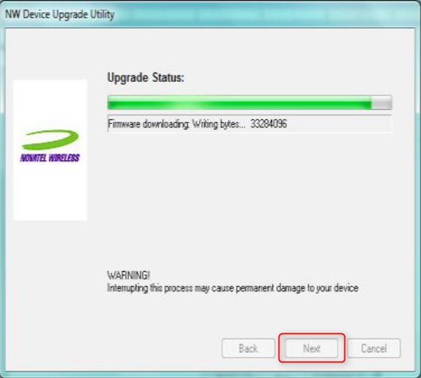

Wizard will start to upgrade modem firwmare. Wait till it finishes, click "Next".
