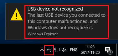

Put your phone in fastboot and connect to PC. You should see warning message in the bottom right corner of the screen:
Device manager will indicate that device was not installed properly

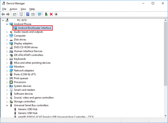

Connect Huawei Mate 10 back to PC, you should see usb key icon in bottom right corner:
Device manager will show it now under "Android Phone" section, which indicates that phone was installed successfully:
