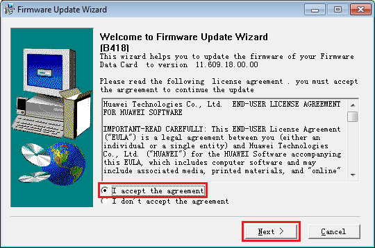

Extract updater and launch "Update_11_609_18_00_00_B418.exe"
Select "I accept the agreement", click "Next"

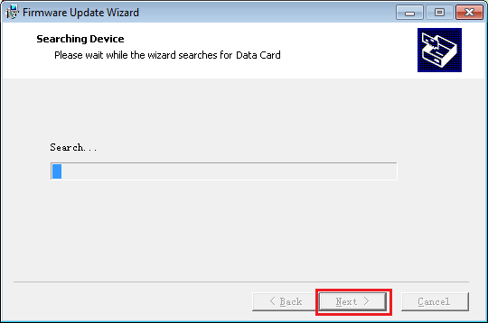

Wizard will search for modem. After modem is detected, click "Next"
Wizard will start to update modem firmware. Do not disconnect modem or turn off computer

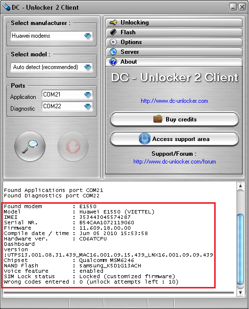

Detect device by selecting Huawei modems from manufacturers drop down menu list, select model leave on Auto detect (recommended), then click magnifying glass button
