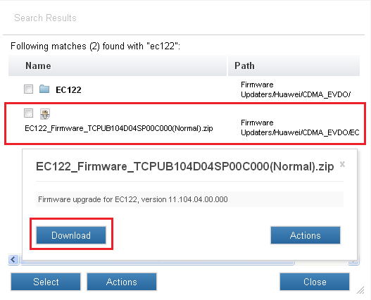

Select by clicking on "EC122_Firmware_TCPUB104D04SP00C000(Normal).zip " then click on download button
Download file

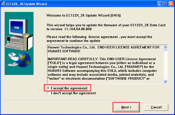

Run the downloaded installation file and update the firmware of your EC122 Data card to version 11.104.00.000, by putting a check mark on I accept the agreement and clicking Next button
Run downloaded file

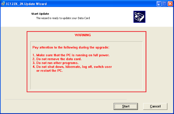

Read Warning message on the next window and pay attention to things you should be aware during update. Then click Start button.
Install wizard

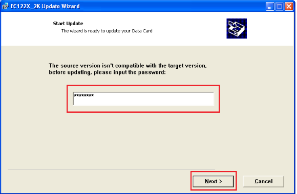

After you click Start button, other window should appear where you need to enter password to proceed with the update
Install wizard

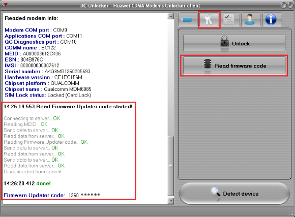

Open DC-Unlocker Huawei CDMA modems unlocker client, navigate to Unlock tab and click on Read firmware code button
Install wizard
Copy Firmware Updater code from the program window and paste it in EC122 update wizard window. Click Next button
Install wizard

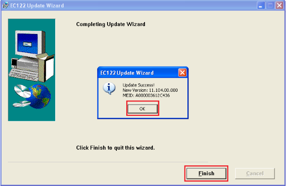

After update is done, other window should appear. Click OK and Finish buttons. Reconnect EC122 afterwards
Install wizard
