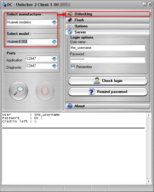

Launch DC-unlocker
Open Server tab, enter your username and password that you received after credits purchase. Click "Check login". (you can buy credits here www.dc-unlocker.com/buy)
Check login
Select manufacturer: Huawei modems, model: Huawei E303, proceed to "Unlocking" tab.
Select Huawei modems and model E303

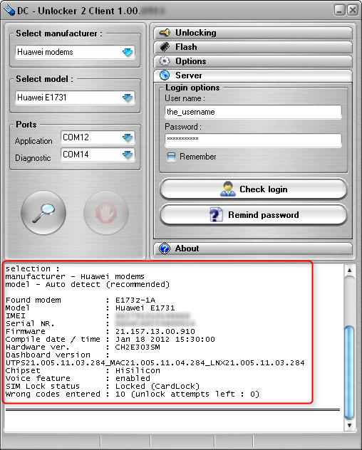

Select manufacturer: Huawei modems, model leave Auto detect (recommended).Press "Detect" button (Big magnifying glass).
Wait till DC-Unlocker fully detects modem.
Modem is fully detected

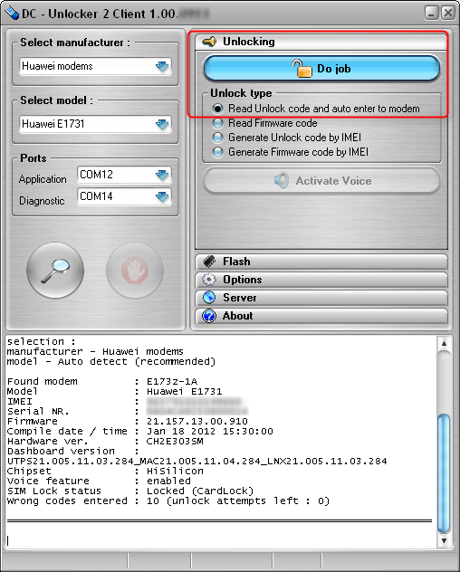

Open Unlock tab, select “Read unlock code and auto enter to modem”.
Click “Do job”.
Press unlock in unlocking tab

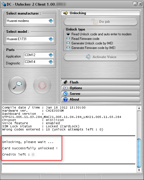

Wait till you see a message that modem is unlocked.
Huawei e173cs unlocked
After you see that unlock is successful, restart modem.
