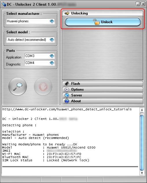

Open unlock tab and press unlock.
Press unlock in unlocking tab
Wait till you see a message that phone is unlocked.
Huawei u8815 unlocked
