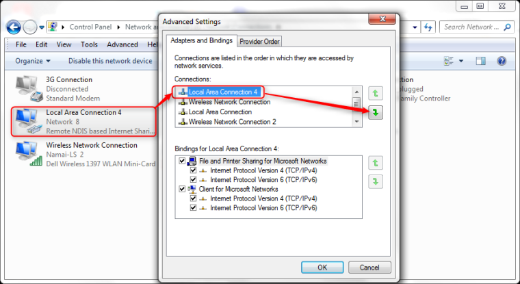

Click Organize > Layout > Menu bar.
Huawei HiLink detect and unlock tutorial. Click Organize - Step 5
Click Advaced > Advanced settings.
Huawei HiLink detect and unlock tutorial. Click Advanced settings - Step 6
List of all connections will appear.
Move HiLink modem connection to the bottom of this list by using arrows.
Click "Ok".
Huawei HiLink detect and unlock tutorial. Move HiLink modem connection to the bottom - Step 5

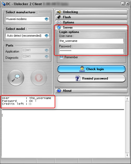

Huawei HiLink detect and unlock tutorial. Launch DC-unlocker
Open Server tab, enter your username and password that you received after credits purchase. Click "Check login". (credits you can buy here www.dc-unlocker.com/buy)
Huawei HiLink detect and unlock tutorial. Check login
